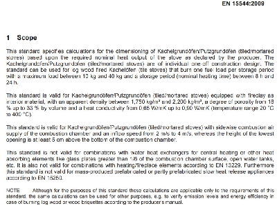

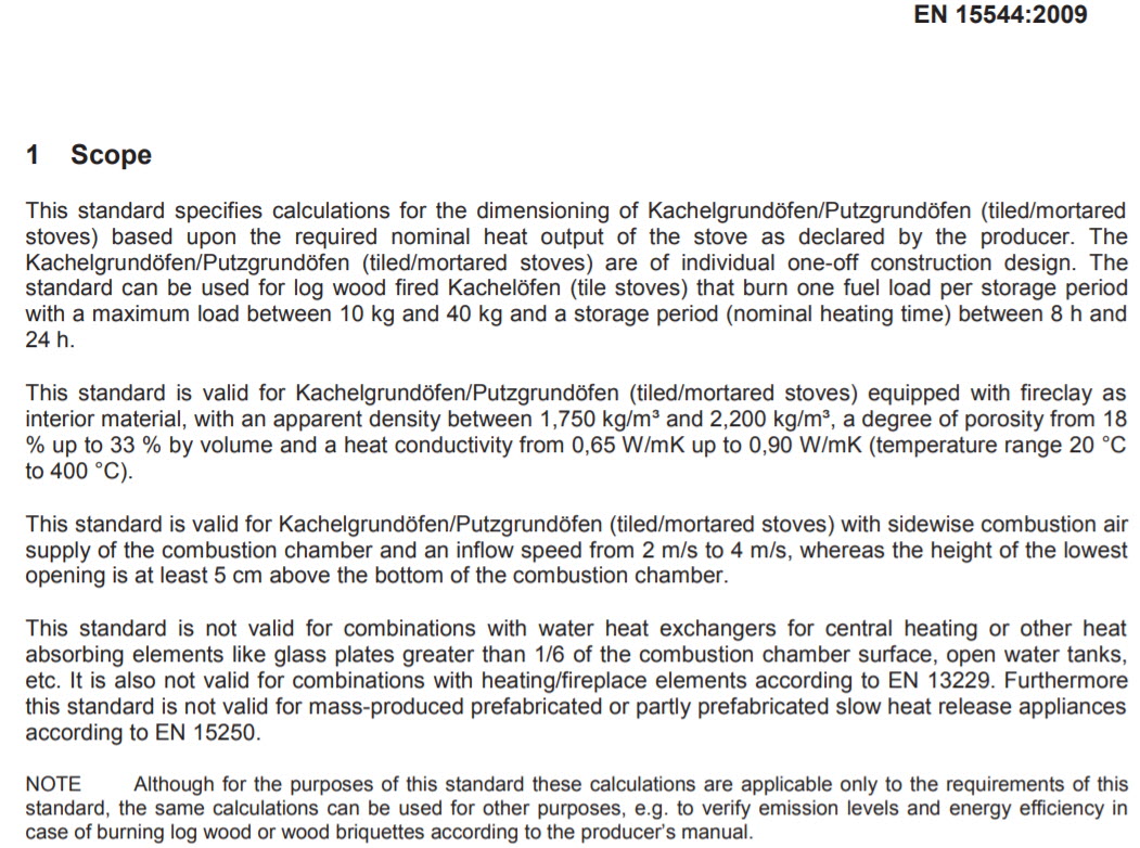

А то директор немецкого кирпичного завода учил когда-то, что при возникновении претензий к печи от заказчика, надо просто провести подтверждающий расчет по ТРОЛ (тем самым отметая все возражения заказчиков и судэкспертов). Боюсь что это не пройдет ни с технической, ни с моральной точки зрения - ни у нас, ни на Западе...
А вот применение для этих целей ЕН 15544 вполне законно. Хотя и ТРОЛ не противоречит стандарту.
Scope:
This standard specifies calculations for the dimensioning of Kachelgrundоfen/Putzgrundоfen (tiled/mortared stoves) based upon the required nominal heat output of the stove as declared by the producer. The Kachelgrundоfen/Putzgrundоfen (tiled/mortared stoves) are of individual one-off construction design. The standard can be used for log wood fired Kachelоfen (tile stoves) that burn one fuel load per storage period with a maximum load between 10 kg and 40 kg and a storage period (nominal heating time) between 8 h and 24 h. This standard is valid for Kachelgrundоfen/Putzgrundоfen (tiled/mortared stoves) equipped with fireclay as interior material, with an apparent density between 1,750 kg/m3 and 2,200 kg/m3, a degree of porosity from 18 % up to 33 % by volume and a heat conductivity from 0,65 W/mK up to 0,90 W/mK (temperature range 20 *C to 400 *C). This standard is valid for Kachelgrundоfen/Putzgrundоfen (tiled/mortared stoves) with sidewise combustion air supply of the combustion chamber and an inflow speed from 2 m/s to 4 m/s, whereas the height of the lowest opening is at least 5 cm above the bottom of the combustion chamber. This standard is not valid for combinations with water heat exchangers for central heating or other heat absorbing elements like glass plates greater than 1/6 of the combustion chamber surface, open water tanks, etc. It is also not valid for combinations with heating/fireplace elements according to EN 13229. Furthermore this standard is not valid for mass-produced prefabricated or partly prefabricated slow heat release appliances according to EN 15250. NOTE Although for the purposes of this standard these calculations are applicable only to the requirements of this standard, the same calculations can be used for other purposes, e.g. to verify emission levels and energy efficiency in case of burning log wood or wood briquettes according to the producer’s manual.
 Размер файла:  262.23 КБ
 Просмотров:  227 раз(а)

так с какой скоростью будете заводить воздух в печь?
Читаем внимательно - combustion air supply of the combustion chamber speed from 2 m/s to 4 m/s
СообщениеДобавлено: Сб 22 Февраль 2020, 19:37 Ответить с цитатойВернуться к началу
Что,конкретно, может дать определение скорости подачи воздуха в камеру сгорания, для расчёта печи?
Может, важнее был бы удельный расход, ведь расход зависит не только от скорости, но ещё и от проходного сечения, а проходные сечения у разных камер сгорания разные(или это предельные значения, выход за которые программой расчёта не предусматривается?)?
Имеются ли уточнения, в каком именно месте, определяется такая скорость и для чего?

Вы откройте ТРОЛ и посмотрите избыток воздуха на горение. Эта цифра не секрет, а обще принята. По ЕН 15544 - 3.25.
Программа, как и ЕН, считает и площадь тепловоспринимающей поверхности и, учитывая шероховатость и направление движение газов, газодинамику тракта.
Зная скорость и удельный расход без труда считаем сечение воздушного тракта ...
Могли бы печникам пояснить, что это соответствует разрежению в топливнике 2,5-10Па.
А то просто так задавать скорость "от фонаря" как-то не очень...
Расход же равен произведению скорости на сечение отверстия.
